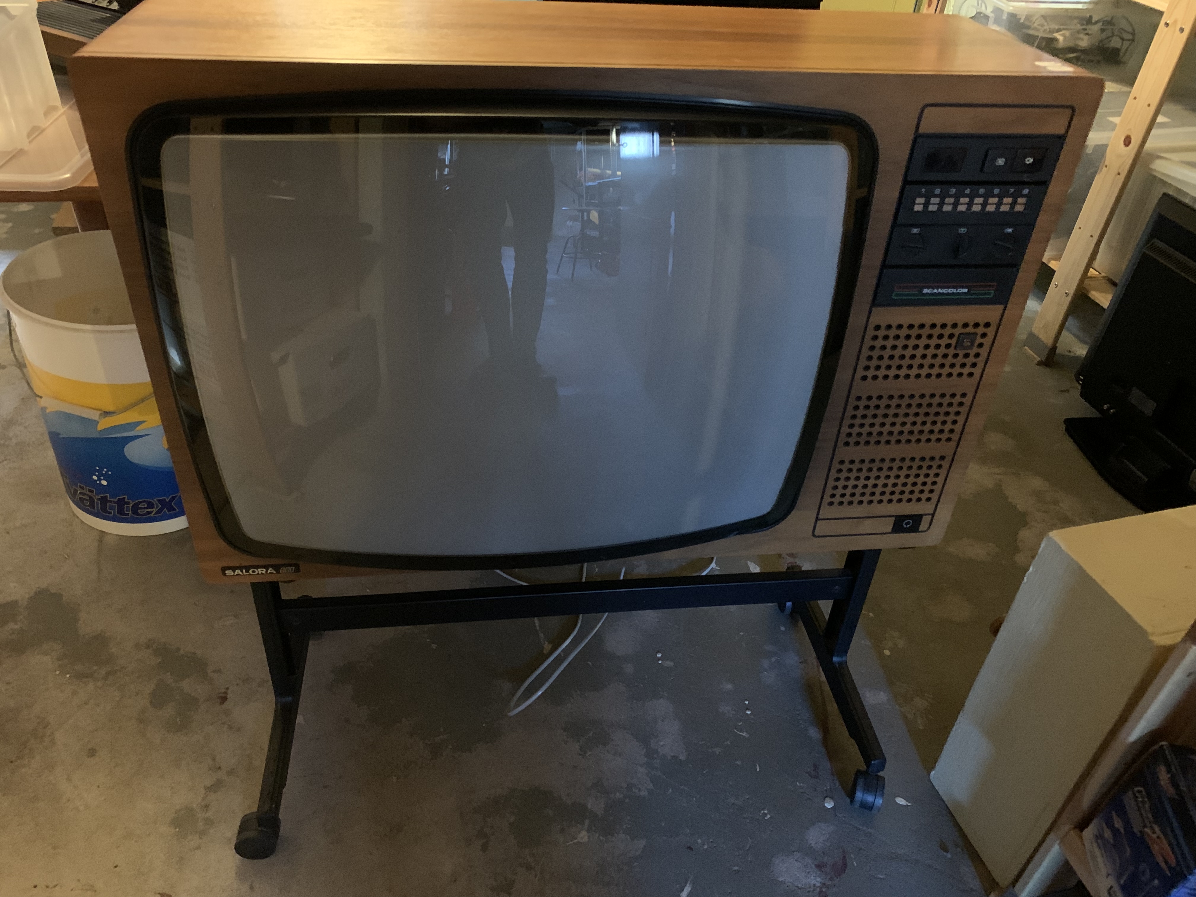

CTV 1980 Salora Color TV (1E0C); Repair help, no red
Hi there! I was pointed here from social media. I recently acquired an old Salora CRT TV from a thrift shop, untested, for about £5. It even had the manual, service schematics and original receipt of purchase (August 1980).
Being a rookie I fired it up after a quick dusting and it worked fine for a few minutes and then it started spewing smoke. To make a long story short the RIFAs are out and the canned cap and fuses has been replaced. After some other minor maintenance the set works great but it's not showing any red at all and this is where my problem lies right now.

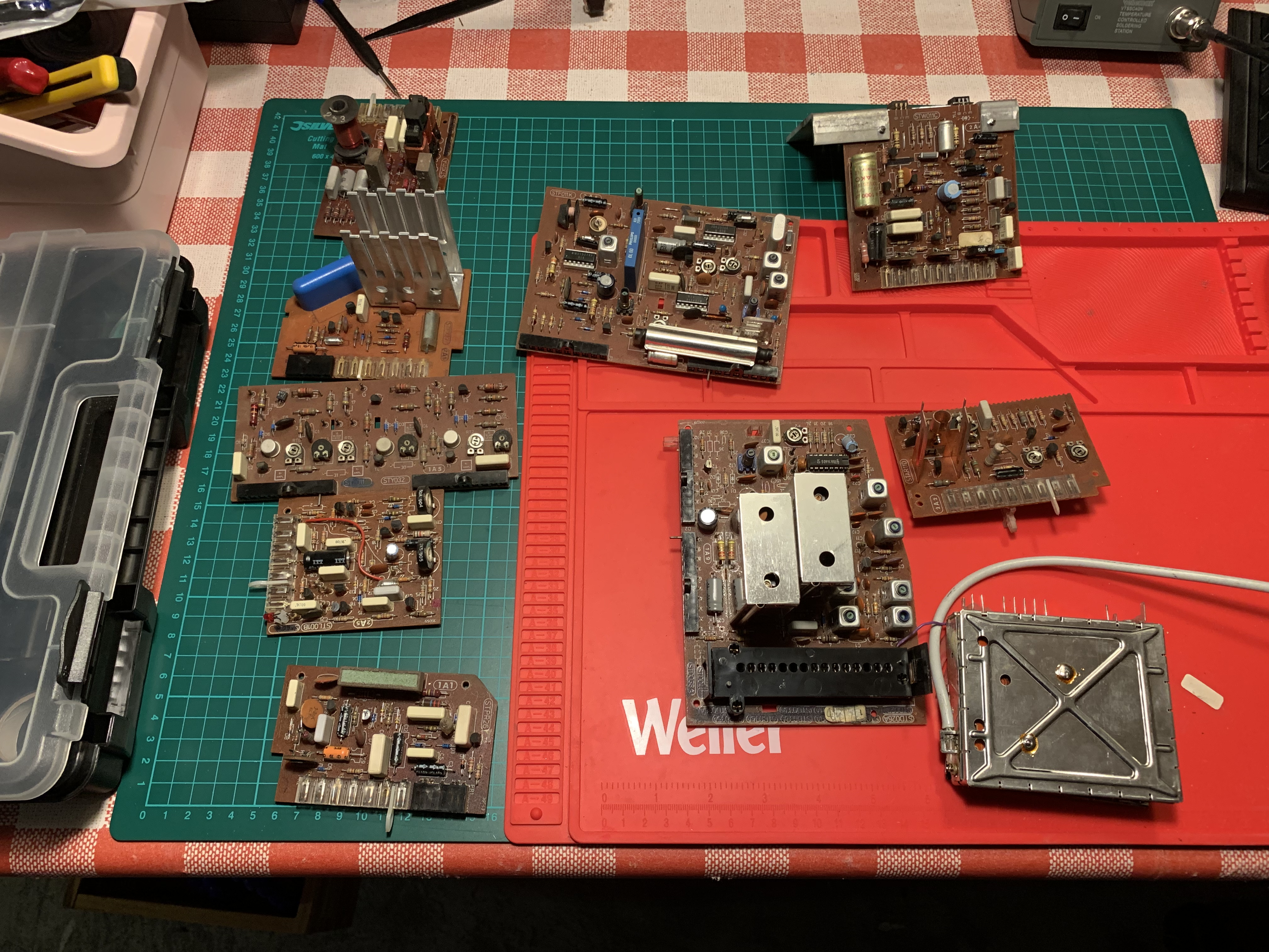

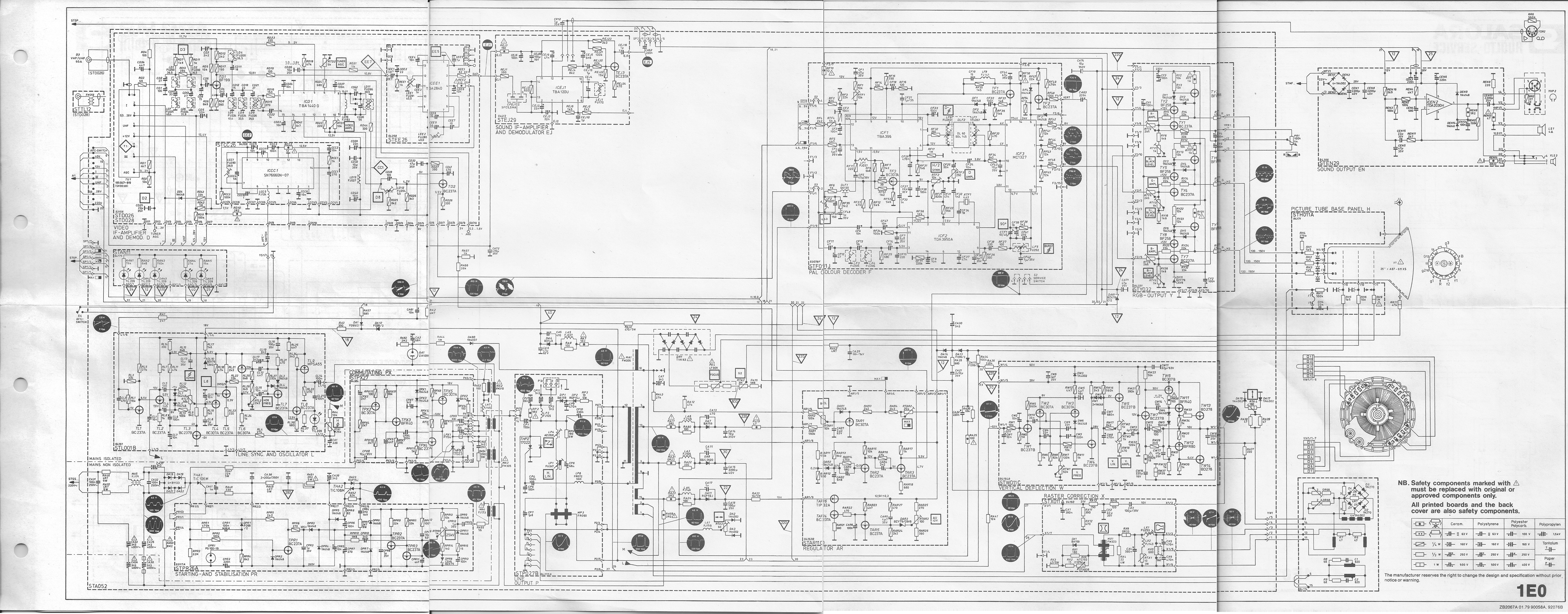

As you can see it even marks oscilloscope points and patterns on the silkscreen. It's like this set is made for fixing and learning <3
All sub boards are clearly defined both in the schematics and are easily detached from the mainboard.

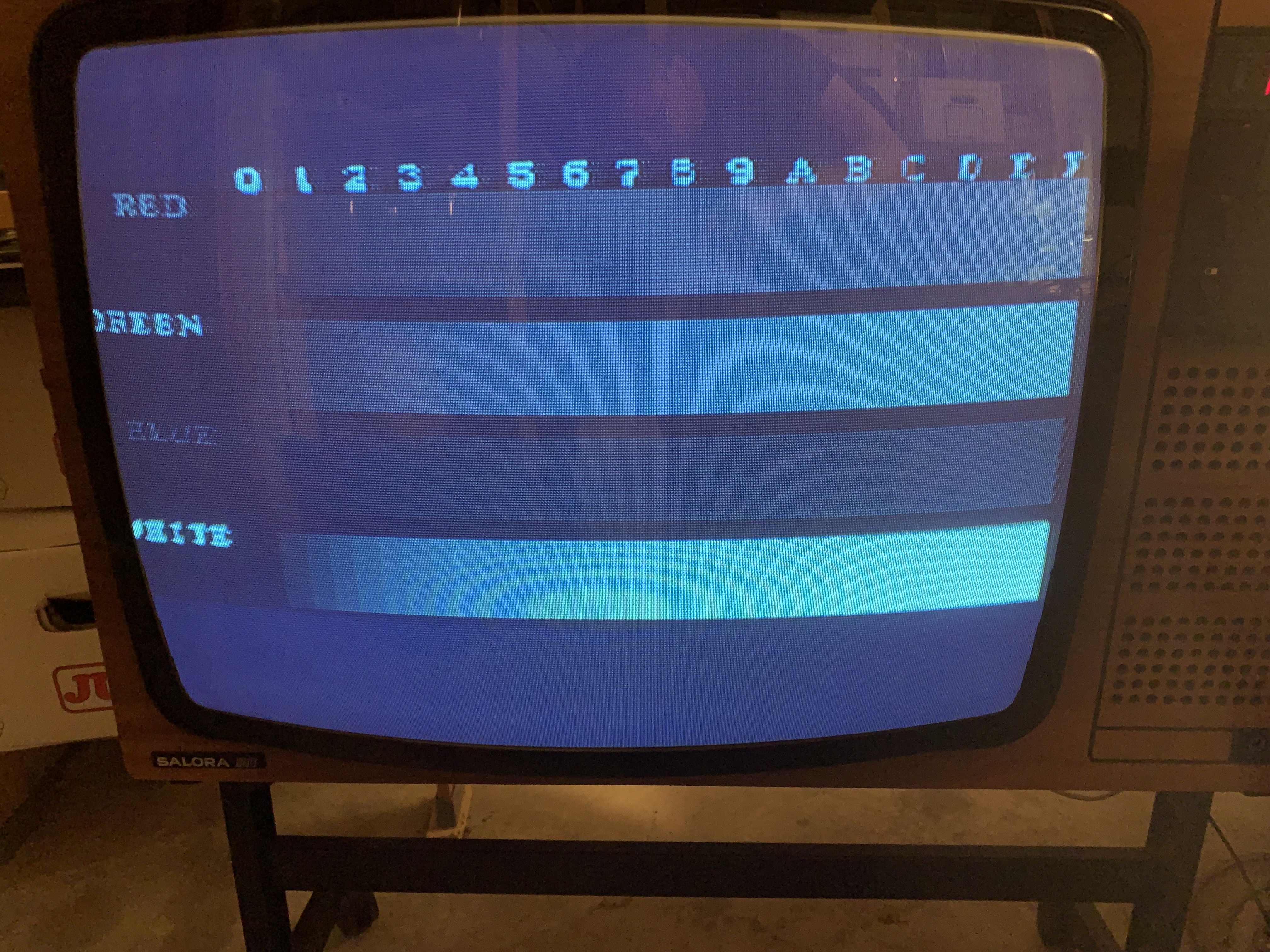

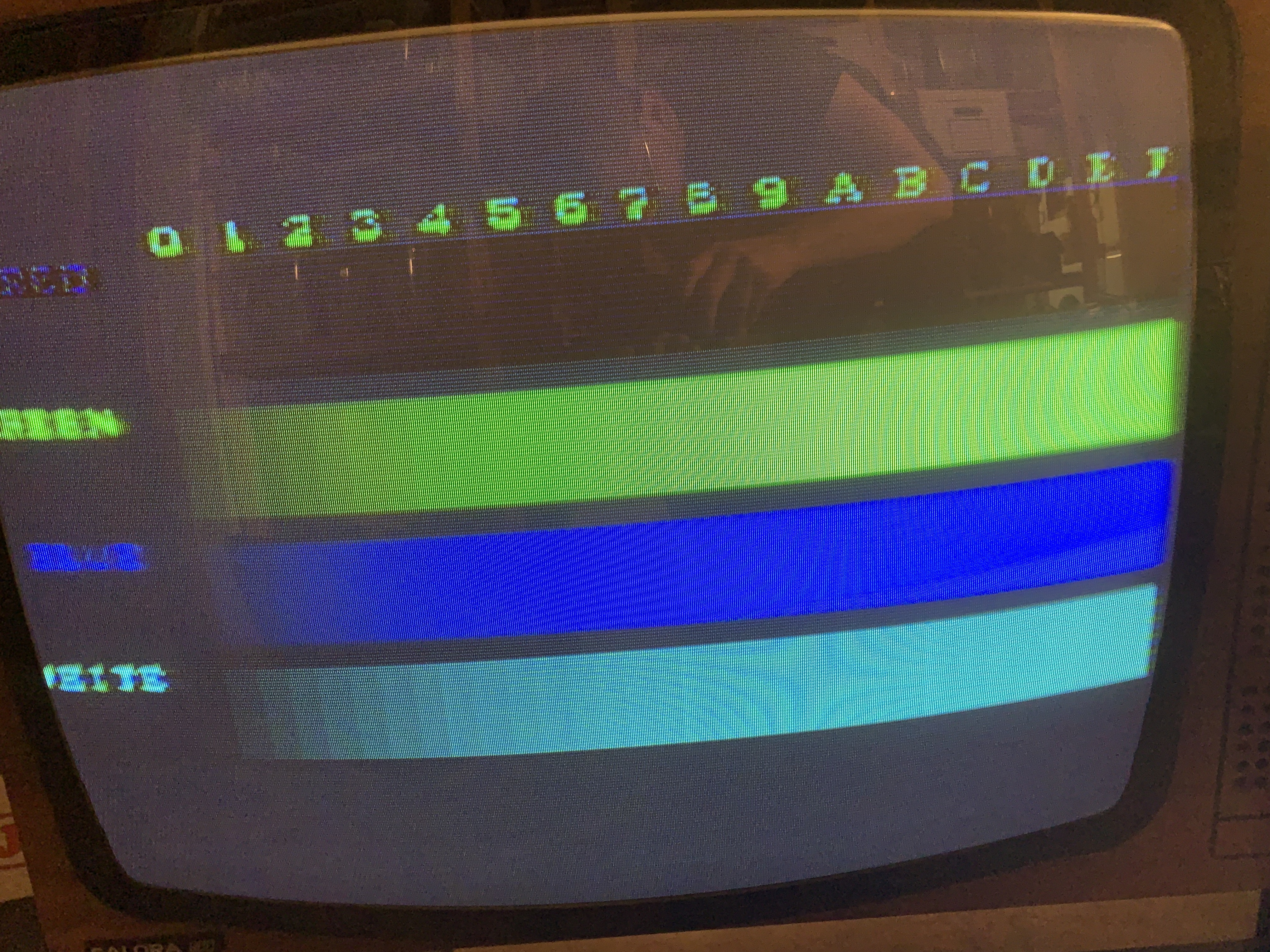

Part of the problem is that I'm learning as I go here, my knowledge and experience is very limited. I don't even own a scope. I do have basic soldering and analytical skills however.
So, yes, the problem at hand is that the tube isn't showing any red at all. However since the rgb output board is so obvious I just tried switching the red and green outputs and the tube started showing bright reds instead of greens so I think we can rule the tube out and I know my input is good.
Using the front knob for saturation however does seem to produce proper grayscale (white bar pretty much looks white but I can't swear on it).
So with my limited knowledge I'm assuming that the problem exists in "PAL COLOUR DECODER" or "RGB OUTPUT" boards (located at the top portion, right of center, in the schematics). As far as I can tell it's the MC1327 IC that first produces R, G and B components so that makes me think the issue is either the IC or later.
BUT then again the saturation knob is connected to the TBA396 and when turned down the grayscale looks correct, which might point to something else.

Ground the Red Cathode, if you get a bright red raster, work back through the drive circuitry, if you don't, tube is shot. Don't leave it grounded too long as this will wear out the tube.
@mfd70 The OP says he has swapped the red and green leads to the CRT base and did give a red display so rules out a CRT issue, whilst I have no issues grounding the cathode with a simple class A output stage I wouldn't do it with this.
@CloakedAlien Does adjusting the red black level control RTY1 have any noticeable effect on the darker areas of the picture? If it does then the fault may possibly be a faulty ICF3 MC1327, if it doesn't then looks like an issue in the red output stage. I'm presuming you have a multimeter so take voltage readings on transistors TY1,2,3 and compare with TY4,5,6 noting any differences. It would be a good idea to check RY1, this is a special fusible resistor and can fail to protect the output stage from further damage due a fault but sometimes they fail for no reason at all. Welcome to Vrat by the way.
John.
@mfd70 Yes, thank you! I did try to switch the cables and I did get red so the tube is ok =)
@Jayceebee Awesome advice! Changing black level on the red did absolutely nothing, touching the same pot for green and blue made a huge difference with small adjustments. Does that mean we've narrowed it down to the output stage? If so that makes it a whole lot easier as the board is easy to detach and trace even for a rookie like me. I don't have IC probes for my multimeter and I'm a bit scared to short anything with the set live.
RY1 checks out at 1 koHm.
T1 = BC 237A
T2 = BF 258
T3 = BFR 88
I suspect the alternative is to desolder these and check with my ESR? How do I tell if they're not working as they should? And are they easily replaceable? (At least the T2 that are cylindrical are new to me)
Oh, I think I found it! RY5 is dead, infinite resistance. Now this just says 22K in the schematics but it's a bigger one, does that mean I have to get one rated for higher effect or would a standard one suffice 40 years later?
It does look as though the fault is in the output stage, before going too deep inspect the soldering of the transistors particularly T2 for dry joints. If you are confident you could even swap the transistors one by one from the red to the green channel and test, make sure the legs go in the correct holes with T1 & 3, it will be hard to get T2 in the wrong way round.
Not sure what you have for an ESR tester, perhaps it’s something similar to mine in the picture. Just simply connect the leads to each leg and a good transistor will give readings something similar. It will also tell you if the transistor is an NPN or PNP type.
EDIT posts crossed. Looks like you’ve found it then. An o/c RY5 would certainly cause the problem. Go with same value and physical size.
